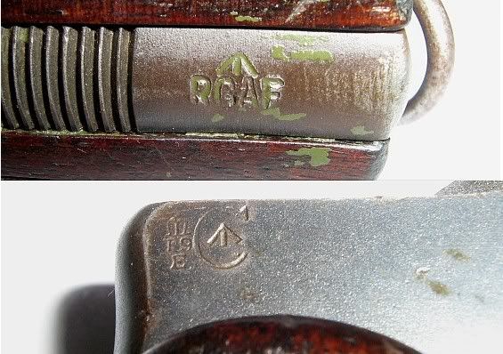

    Quote Originally Posted by Lyman1903 View Post
    Enfield No2 Mk1* 1940 J3902 on barrel and frame w/ Canadian proofs, also has SLI or SL1 on frame just behind the hammer, wood grips
    By "Canadian proofs" I suspect you mean Canadian military acceptance/ownership markings (e.g. the C-Broadarrow as seen in the last image in my post #321 above) since Canada has never really had a formal firearms proof law .....
    The frame behind the hammer was the standard place for unit markings, and the stamp there is presumably "SLI", denoting the Saskatoon Light Infantry - http://web.archive.org/web/200803052.../archives/sli/
    Grant Rombough
