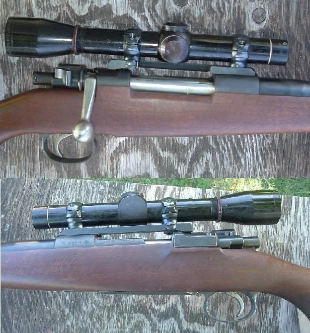

    Here's my Sporterized Czech Brno Brazilian 1908/34 7x57. I wish I could find a couple more in decent condition. IMO, one of the best '98 actions around.
  16. #15

    Quote Originally Posted by Ron Smith View Post
    Great job on the rifle! The stock sure looks great.

    Thanks! I've been doing stock for about 30 years or so. I bought the rifle from an estate. Someone had made an attempt at shaping it, but still pretty awkard looking. I was going to put a nice walnut stock on it, instead I decided to salvage the maple stock since it had some decent figure.
    I like German Classic Sporters, so I decided to build one that I could drag out into the woods without damageing an expensive rifle. I found this one at a local shop. The stock was sanded finished , but still basically the same as it came from the maker. I reshaped it into the Classic German design. It needs a bit more shaping and slimming.

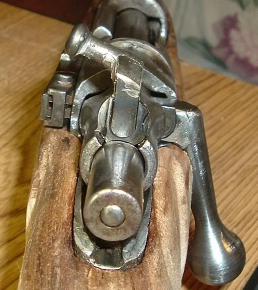

    Default Received FN Mauser 7mm 24/30 - pictures
    Received the FN Mauser. All three serial numbers match, receiver, bolt and barrel. The barrel rifling and bore are excellent. There is virtually no rust or pitting. The Venezeula crest on the receiver is in perfect condition. Does anyone know the twist rate on this rifle as shipped from the factory? I don't feel bad turning this into a hunting rifle since "Bubba" had already changed the butt plate, installed a different front sight and cut the stock. I will order a Boyd's JRS laminated stock that's finished, a Bold trigger with integral safety. The new shroud to replace the current safety is on its way from Midway USA (Brownell's had back-ordered this item).
