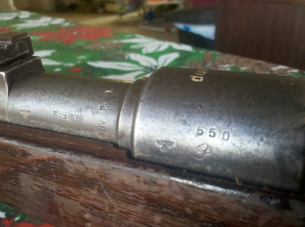

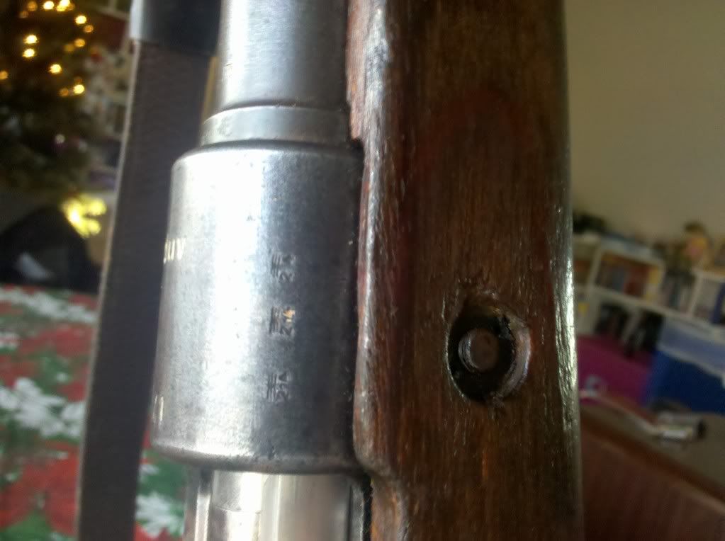

    41 duv 550 g Barrel Code - 41R5

    Mine is 1941 duv, with a script "g" under the serial number, which is "550". it is not Russian capture marked, and no markings are peened. Imported from Germany. I don't know exactly what's what, so I'll post a pic..
    - Spike
    Last edited by Spike 7.62; 12-16-2010 at 01:38 PM. Reason: i am an idiot and cant read numbers

    Thanks Spike, sounds like a "g" 1942 rifle...the Germans numbered their rifles 1-9999 (usually, there are exceptions), then after 9999 started over at 1, but added a letter suffix, "a", then "b", and so on....high number production years they even went to double letters...check to see if all the serial numbers on the parts match, and if you can post the barrel code (usually under the woodline, so you'd have to remove the action from the stock to see it)....barrel codes are especially helpful in research...

    I looked just now, the barrel code is "41R5", its in line with the "duv" mark but in a different and larger font. Further up on the barrel is a lone "K".

    Spike....I am at work, and therefore cannot see any pics (they don't upload here...) and will not be able to see them until I get home. Could you double check your rifle as suggested by Simson? Just want to make sure everything is accurate, especially as this info is important in the research...

    My sincerest apologies! The rifle is 1941, writing 1942 was a typo error and a brain fart, considering I had the rifle right in front of me. duv 41, serial 550 g, barrel code 41R5. Sorry again for the brain-to-fingers fail.

    the 3x E214 on the side of recevier is dead give away for 1941. 1942 they stopped this process and moved to top of rec . did't really abandon over the last few moths i have had only 2 reports given to me and i updated the thread. Berlin Lubeck are a scarce manufacturer for observations. so much so they never sticked this for me on gunboards forum. they have it sticked elsewheres which still brings in very few reports. I have added 27 to the list from my own research 3 from others progess none the less .
